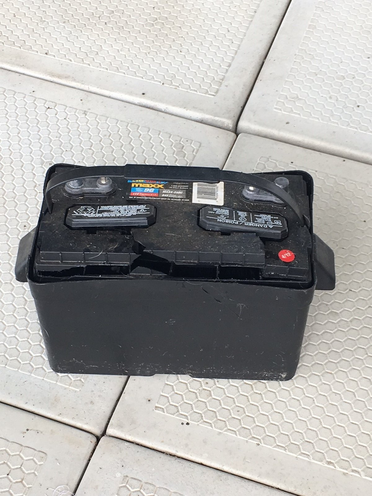

    Also, a safety tip- if your battery has the ability to be topped off with distilled water or electrolyte, check regularly. I have another boat (Carver 3307) and had not checked fluid levels since I bought the boat. Went to crank the Port engine, and BOOOM! The battery had dried up due to in line charger, and the demand for power caused an explosion. So kids- check those levels. Boom Battery.jpg
